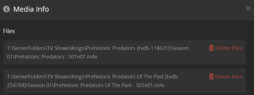

I have two TV shows that are separate but Plex keeps labeling them as a single show and thus the episodes as duplicates. Here is an example:
How can I get Plex to see these as separate shows: “Prehistoric Predators” and “Prehistoric: Predators Of The Past”?
Which folder is added to the TV show library?
If it is TV Shows, then you need to move the shows up a level, eliminating the Kings folder, as such a structure is not supported by Plex.
Also, Plex Dance the shows, returning them one at a time to the TV show library.
You are correct, and I have already configured Plex to add “T:\ServerFolders\TV Shows\Kings” to the TV Show library. So, unfortunately, I don’t believe that is the problem here.

Plex Dance did the job. Thanks!
