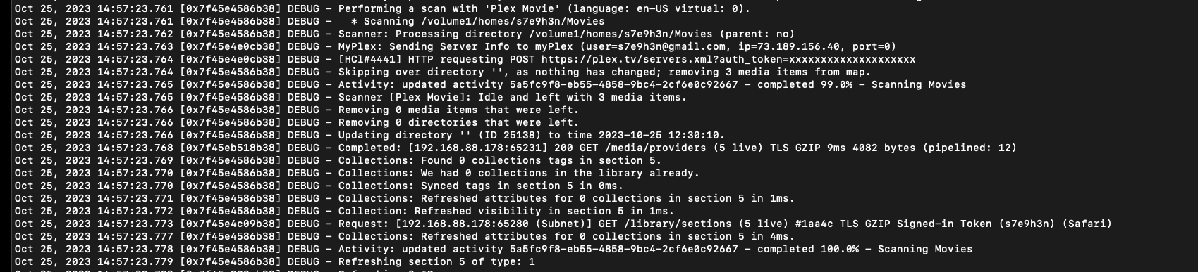

I can do this but it will take some time. Need to move some files back into my home directory, remove the current ones from Plex, and rescan. I did tail the server.log file yesterday while troubleshooting and it didn’t show any errors:
The only way I could get the contents of the subfolders to enumerate was to change the scan engine from “Plex Movie” to “Plex Movie Scanner”. I know, it doesn’t make sense but I guarantee you this was the case. Happy to work with you offline if you’re really curious about this bug. Not sure how or if this forum has DM capability…
