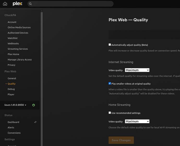

The ONLY, and not really viable, workaround is to preset the quality low then change up after it starts.
Would you try that ?
I can not seem to find an option for setting the quality before the playback starts, but upon further investigation, on the android and LG webos app the transcoding seems to be fine.
I was aware of the buggy web client, but I have the same issues with the windows apps, MS store and Plex desktop, they throw random errors when I ask the server to transcode (4294967283, 4294967279 and others).
I was suspecting that somewhere the new stream was not getting passed or picked up by the client correctly, what is beyond my understanding is why when I rollback to 470 drivers the playback is perfectly fine across all players and devices.
I tried rolling back multiple versions of pms till 1.28 but had the same issue across all of them.
Once you’ve crossed the 140.x barrier, there is no going back. — risk of corruption is high
The databases are not compatible with each other (except forward migration)
Had to uncheck recommended settings for the menu to pop. You are right, transcoding works if I don’t change the quality.
