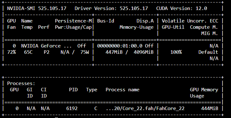

Here is my nvidia-smi (you can see the Folding At Home process is running)

  2. Regarding your Nvidia drivers version, I am always VERY skeptical of increases.
    You’re running CUDA 12.2 while I have 12.0 (which is known to work – Ubuntu vetted)

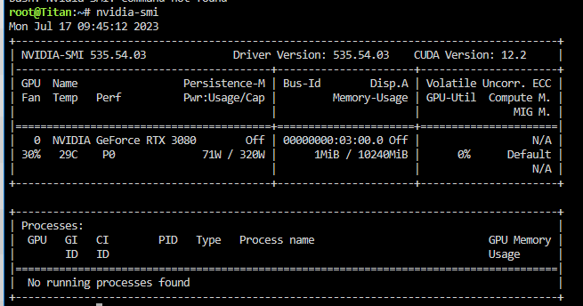

Hello, just to add to this discussion. I am also dealing with the same issue as lonewolf147. To be clear, I believe we are both have PMS installed as a container on Unraid.
I did revert the NVIDIA driver back to v470.182.03 and the hardware transcoding is now working. The only issue now is that I don’t have the ability to change the quality of the video during transcoding, it automatically goes to SD quality.

Hey everyone, came here to say that I am having seemingly exact same issue. I use the binhex-plex docker on unraid 6.12.3 and PLEX seemingly refuses to use my GPU now.
my PMS logs say this:

Ich777 helped me up in the unraid forum. I have no idea what happened, but I had to set this all up again:

ii  xserver-xorg-video-nvidia-535-server  535.54.03-0ubuntu0.22.04.1              amd64        NVIDIA binary Xorg driver
