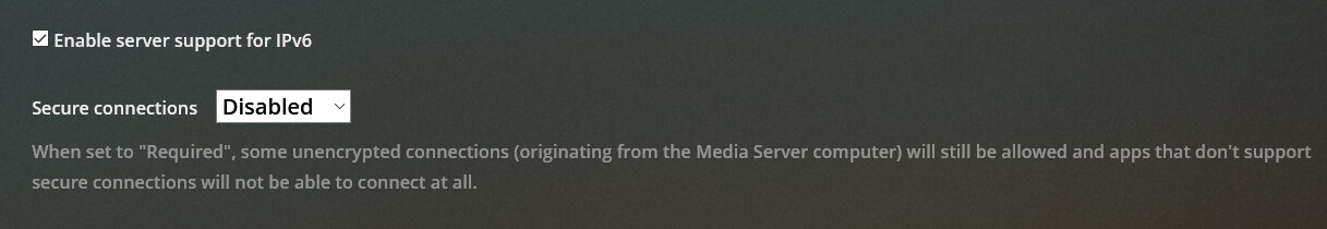

What are secure connection settings set to on server? in the app is it set to allow insecure connections (if you servers secure connections is off)
Server is set to allow insecure connections
do you mean the LG app?
( as side note if you don’t need IPv6 I would disable that)

So I just added my tv’s IP address to the list of IPs that don’t need to authenticate and it fixed it. What a buggy experience…
both are setup to allow insecure connections

yes, both server and smart tv are setup to allow insecure connections
hey did you do this in the server settings via a PC/web interface?
If you mean the Networks Allowed without Auth setting. Yes it is in the network settings of the server
