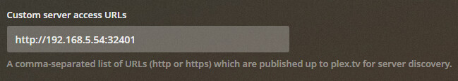

Can you go to Network settings for the server (in Plex web), show advanced and check what if anything is entered for Custom server access URLs?
For my setup (I’m using port 32401 which passes to port 32400 in the container) I need to add the following otherwise the docker container only publishes it’s internal docker IP (and is unaware of my mapping from 32401 → 32400):
If nothing is there could you add http://IP-of-synology:32400 and save the settings, then restart the app on the TV?
