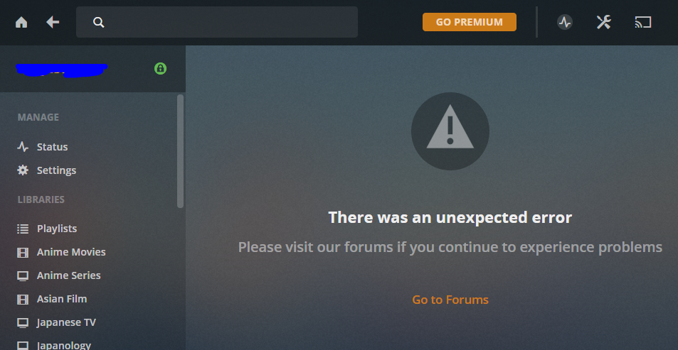

Update Version 1.14.1.5488 Error There was an unexpected error loading the dashboard
Server Version#: Version 1.14.1.5488
Player Version#: web browser
After update, got error. tried repair tool on new download of version 1.14.1.5488 no luck same issue

Same issue here after latest update.
"There was an unexpected error
Please visit our forums if you continue to experience problems"
First started showing up when going into some tv shows, now showing up in home.
A rollback to Version 1.14.0.5470 seems to have resolved the issues.
