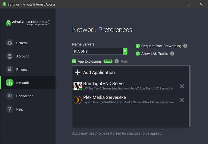

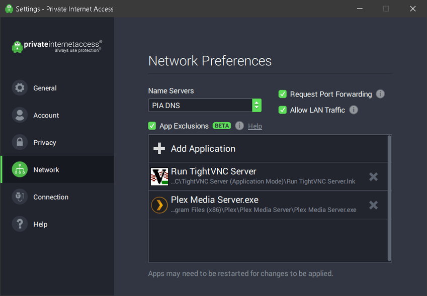

I do use a VPN (Private Internet Access), but i’ve added Plex as an exception in that it bypasses the vpn:
Ok, interesting. I think i’ve narrowed the issue to my VPN client. The addition of the exclusion of PMS seems to cause an issue. If I disable the VPN altogether, server settings are accessible. As soon as I enable the VPN client, the server settings become inaccessible.
I have removed the exclusion of Plex in the VPN settings and now Plex settings are accessible (both via localhost and pc ip address) even with the VPN connected.
The problem is with the VPN’s “App Exclusions” feature. I know they recently added this. It appears it may be a bug with that feature.
