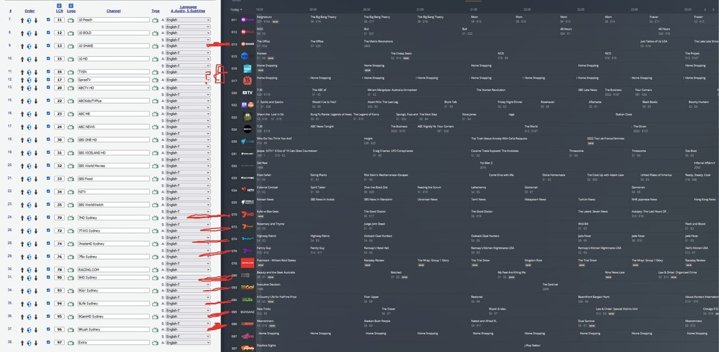

From my understanding, you can reorder the channels and move them up/down the list by doing something on the VBox device (see the arrows/Order LCN in my top image of the VBox channel listing above. I have simnply accepted the VBox listing and left it unchanged as I had no reason to change what I didn’t see the need to.
You will notice in the listing (above) that channel #1 and channel #10, are both the exact same channel (10HD). To my understanding, channel #4 is the same as channel #25 (7 Sydney); #5 and #32 (Channel 9) are the same too. I’m pretty sure that they are the only duplicates in the listing.

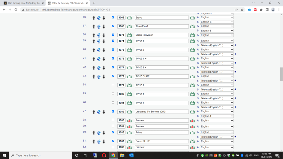

Here is an example of a SAT in NZ. As you can see, the duplicates are un checked or it makes plex fail.
It’s also important to note, that 7HD Sydney is still 7 Sydney so you must choose HD or non HD but only one - like Highlander :slight_smile: I can see you have these issues for 10, (LCN 11 and 15) and others that have been failing.

From my reading above, I should select the best of each channel in the VBox channels list and untick other instances of the same channels in the list. In this regard, I’ll select Channel 7HD (in preference over Channel 7; and Channel 9HD in preference over Channel 9); I’ll go through the whole VBox channel listing, selecting one instance only of each channel then do a reset of the Plex DVR so it only finds one instance only of each channel in the VBox channels output.

I have used the following VBox_3442 Channel settings and matched against PlexDVR ProgramGuide:
All channels marked in RED and matched against VBox_3442 selected channels list still failed to play with the Playback error.
I’ll upload a new copy of the error debug log.
Plex Media Server Logs_2022-07-26_20-10-26.zip (4.9 MB)
AS I was doing this test I realised that Channel 37/97(Extra), 11/16(TVSN), and 12/17(SpreeTV) seem to be general shopping channels and not something I care about - so why bother with them. But WE are still not resolving the problems with the other Channels also marked in RED., the Channel 7 group and the Channel 9 group.
