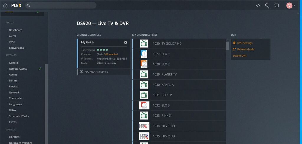

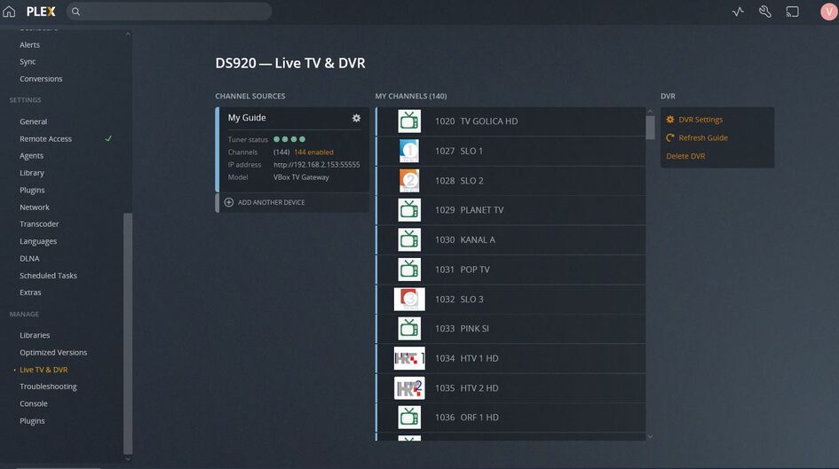

Plex vbox live TV and DVR
Server Version#: 4.63.0
Player Version#: 1.24.5.5173
Tuner Make/Model: vbox 4144
Guide/Lineup name:
Using XMLTV?: no
Channel number/Name:
Plex find vbox , scan channels and scan guide. when I try to play something I get playback error.
debug log attached :
plex debug.txt (147.7 KB)
Thank you for the screenshot and the Plex Web log
