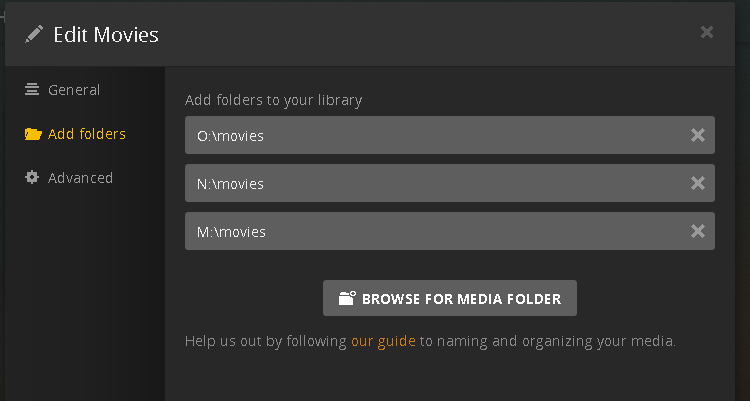

Are they organized into “one subfolder per movie” or are just in one common folder?
one movie per folder., sub folders for extras
root folders;
