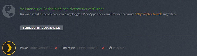

yes it switches back and forth every now and then…I now also had some who have managed to connect but the majority writes they do not get on it…es seems to have some kind of loose contact…some manage to autentify and others do not
Currently it looks like this for me:

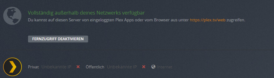

I noticed the same thing, and rolling back didn’t help me either.
However, despite saying “Not available outside your network”, it does seem to be accessible for me.
I’m seeing the “not available” message like others.
