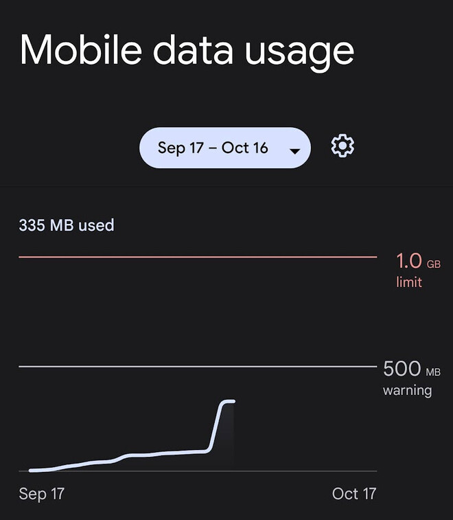

My weird mobile phone plan is EXTREMELY expensive, so much so that I don’t use mobile data for anything other than text-based sites and navigation. If I touch the wrong thing on the screen, it costs me a quarter, or a buck, or more! So, I never stream content and I make heavy use of the downloads feature in Plexamp. I have of course configured everything possible in Plexamp to not use mobile data.
The other day, something weird happened and Plex started consuming mobile data. It quickly used about 200 MB and triggered an OS warning on my Android phone.
200 MB, you are all laughing because that’ nothing… On a normal plan! But it’s $2 on my plan and if I didn’t get a handle on it ASAP it could have cost a lot.

  • I drove away, lost wifi, and quickly got a mobile data usage warning, at which point I pulled over and panic quit Plexamp, haha.
So I do not know exactly what happened, but my impression is that Plexamp began download on wifi, and when it lost wifi it switched to mobile data even though it was configured not to do that.
