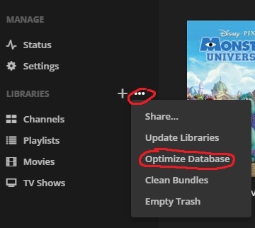

On the line that says ‘LIBRARIES’ in dark gray it’s under the … menu.

Yep Optimize seems to do the trick
  1. Optimized via through your picture.
  2. Turned the “Enable Video Thumbnails” back on
  3. Optimized again just to make sure
And either Xbox-one is using cached items or it’s working as expected.
But It works
Side Note this also fixed the 5min Load on Roku
Thanks So Much
