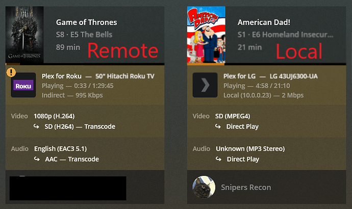

  1. Yes, I am able to play videos from outside my network
  2. What remote access settings do you mean? ipconfig /all and/or the forwarded port in my router or this:
  3. Currently using automatic remote access (not manually specifying a port) with UPnP enabled
re #2:
ok… got this one confirmed.
the relevant information is the 3rd line next to the client icon:
  • remote: Indirect -- 995 Kbps
  • local: Local (10.0.0.23 -- 2 Mbps
When your remote setup is fixed / troubleshooting succeeded, the indirect label should show Remote instead.

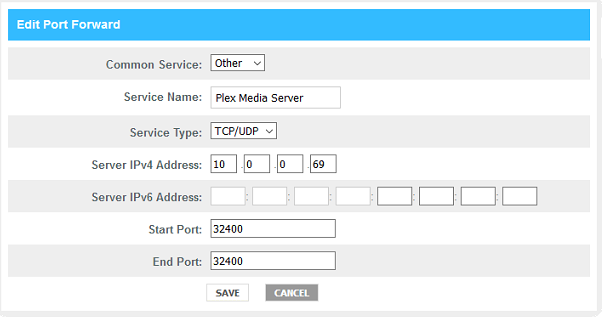

Let’s try to establish a port forward in your router.
You can use 32400 as the public TCP port but you can also use pretty much any other port.
When you have configured the port forward, make sure to check Manually specify public port in your Plex settings, enter the port you configured in your router and click Apply
Capture3
Capture4
With these settings & the port (32400) specified manually it still says “not available outside your network”, and it says “the server is currently unavailable” when I try to access the server’s plex settings from a different computer via Teamviewer.

I just noticed that your router doesn’t allow configuring different private and public ports… so technically if you assign port 80, this will connect to port 80 on your local network as well.
Hence you will only be able to use port 32400, as that’s the only port the Plex Media Server on 10.0.0.69 in your home network is listening.
