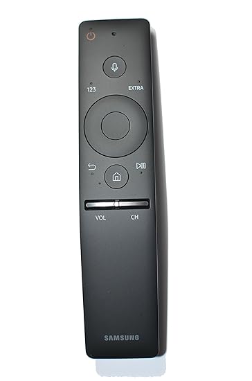

I don’t see the “yellow” button on my KS8000 remote though…?
picture of remote

Installed the userwidget and I hit the yellow button after seeing the issue again. On my remote, I don’t have a physical yellow button, and had to open the “123” menu to do it. Nothing happened when I hit it, so I don’t know if it successfully sent logging to you guys.

Installed and clicked yellow button from 123 button.

if you press the EXTRA button, you should get some onscreen instructions with the coloured buttons
