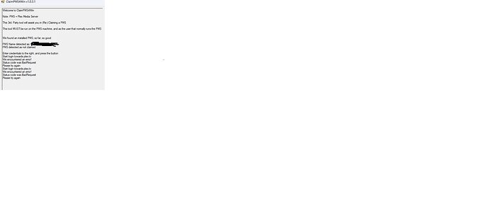

Thanks again, in addition with the PMS reclaim tool I encountered this “BadRequest” issue when entering my credentials.
It does see my server, though.
That is totally expected, as it signs out all devices from your account. That includes your server.
See New Claiming Requirement for Windows
