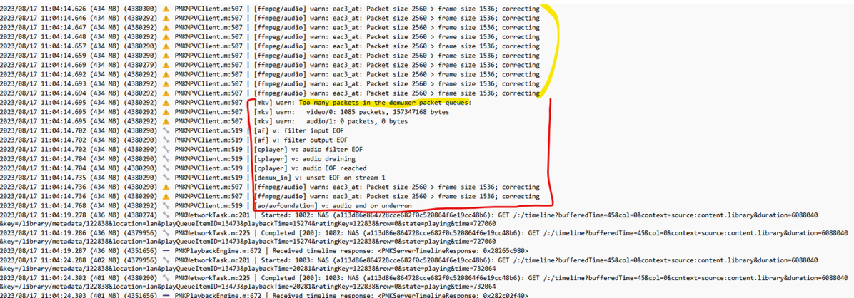

In of one of the linked threads someone found this right as the issue occurred

If the above snippet isn’t enough of a clue please let me know and I will grab some full logs on my next days off which will probably be midweek.
The snippet helps but having full logs would be great as they tell a bigger picture of what led up to those log lines… feel free to DM them to me.
I asked this in the fireside chat happening right now. Plex Fireside in the Forums - #37 by chrisallen
One more question on those logs.
I’m sure when I posted the above screenshot, the op that took them said he had enabled verbose logging. Will that be necessary?
Also do you require client (Apple TV) logs also?
I would just rather get it right first time. :joy:
For now getting Client logs (Apple TV with you playing audio to the Homepods) with verbose logging enabled would be best. Feel free to include server logs that cover the same testing period as that should tell an accurate server/client picture.
