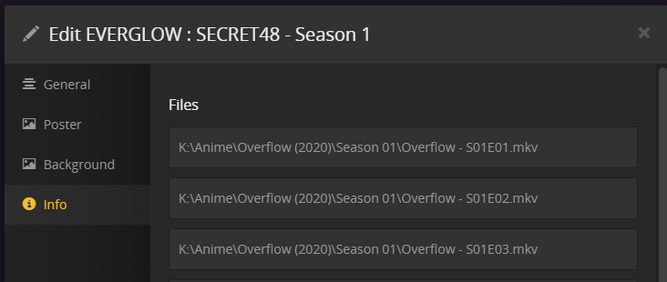

I made sure to name the folder “Overflow” and the episodes as well.

I made sure that the details are set properly for the file itself.
2022-09-27 12_09_47-Window

  1. add a Season 01 subfolder. Even though this particular show does only have one season currently.
  2. Name the folder of the show at least Overflow (2020) https://support.plex.tv/articles/naming-and-organizing-your-tv-show-files/

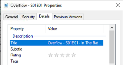

  4. The file’s “Title” meta tag must only hold the episode’s title. Nothing else (or nothing at all).

I can’t seem to clear the metatag, there is just no checkbox. I tried to “Create a copy with all possible properties removed” and it still stuck around.

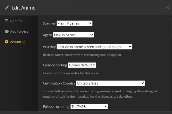

Which metadata agent has been selected in the properties of the library?

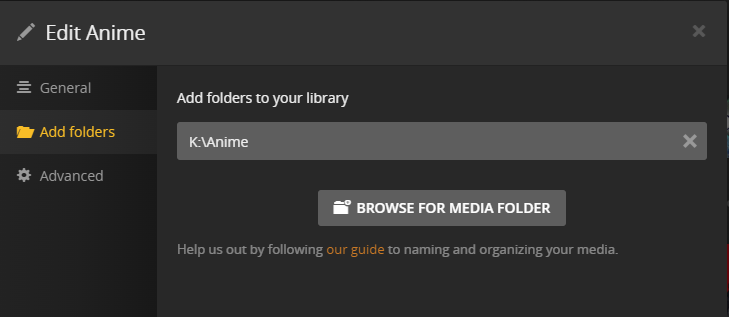

Which path appears on the “Add Folders” tab in the properties of the library?

I believe the agent is Plex TV Series
The folder is the following:

I’ve tried to remove the tags with Mkvtoolsnix and everything is still present :confused:
Have you tried using the tag in the folder name for the show ? Like this Overflow (2020) {tvdb-373728} and make sure Include adult content is enabled in the advanced settings of the library.
