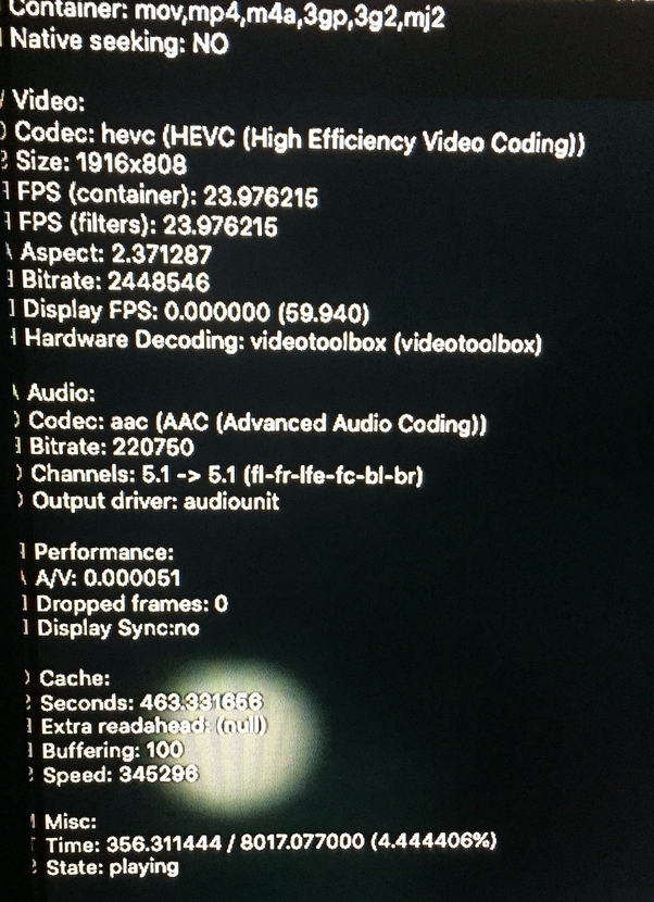

Also in the app settings you can enable Show Enhanced Video Player Debug Overlay, it will show an overlay with tech info on top of the video player, with some relevant data like the number of dropped frames.
Could you enable that and keep an eye to the number of dropped frames? In theory, when the problem you describe occurs, that number should be increased.
Could you take a photo of the screen when that happens and share it with me? (Important: cut out the first line in the overlay with the file URL from your photo, since it contains the token to access your server)

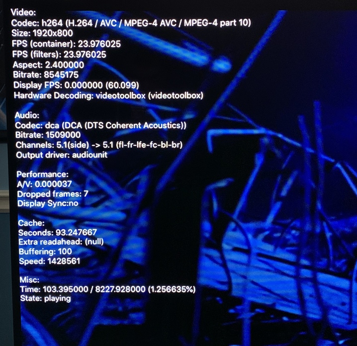

Having enabled the debug overlay it doesn’t appear to show any frames dropping during playback. The 7 dropped frames present were immediate after hitting play. This photo was taken after about 5-10 seconds of the stuttering. Other info, I do not have “Match Frame Rate” enabled on the tvOS settings.
I can confirm that if I do enable the match frame rate it does fix the issue but does create an audio delay.

Can you post your debug overlay as well?
When framerate drops it does not get reflected in the stats at all seemingly.
Framerate stays and dropped frames stays really low/next to 0.
This happens to both h264 and h265 encodes.
Both high and low bitrate content have the same issue on both players.
But seeming does not happen to 4k HDR h265 encodes when testing it.
[image updated with token removed]
