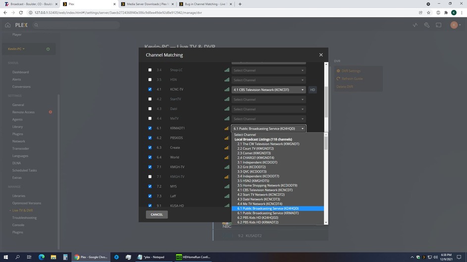

In my area, there are two PBS 6.1 signals in the channel matching window. PLEX defaults to the first signal, and when I try to change it to the other signal, it ignores my selection. I can select any other signal that I want, but when there are two 7.1 signals, it again won’t let me select the second signal. The old channel match dialog didn’t have this problem. Please fix!

As you can see in the picture, there are two 6.1 signals, K24HQD, and KRMADT. The K24 signal is weaker than the KRMA signal, so I don’t want to use it. Just for grins, I scrolled down in the list and randomly selected other signals instead of these. I was able to select other signals, until I go to channel 7.1, which actually has 3 signals. Once again, it would let me select the first of the signals, but neither of the next two.

The issue relating there being two 6.1 channel entries in the Lineup (the right hand side drop-down list in channel matching) has been reported and I expect a fix to be released in the near future
This relates to the list of channels on the left hand in the channel matching dialogue box. The left hand side is the list of channels from the DVR Tuner. I have not investigated any issues with duplicate channel numbers from the tuner side - my investigation has been in how we deal with duplicates in the lineup (right hand side drop-down)

There is no problem with the left hand side. There is just the one issue with the right hand side, I was just describing playing around with the right hand side, seeing if I could get any of the right hand duplicates to work. I will wait for the update. Thank you!

The issue with 6.1 is understood and will get fixed
I will ignore your references to 7.1

I expect the fix for handling lineups with multiple entries for the same channel number (vcn / lcn) to be released in Plex Web version 4.75 which will initially get released as the hosted app through https://app.plex.tv/desktop
The fix for handling lineups with multiple entries for the same channel EPG source data has already been released in Plex Media Server beta 1.25.5
