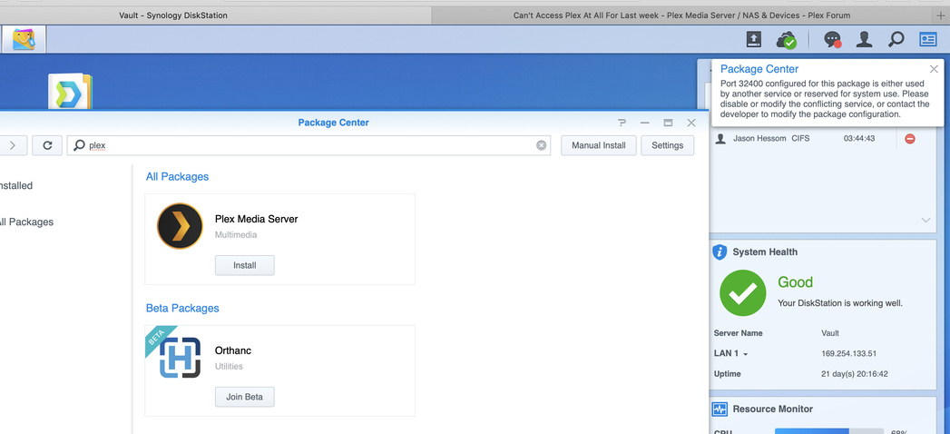

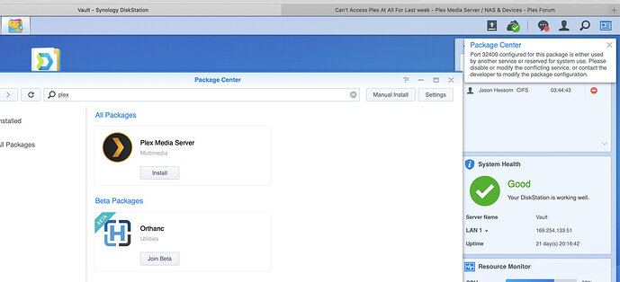

I uninstalled plex.. I reinstalled it from package center, clicked install, and take a look at the message that was flashed in the upper right hand corner of the screenshot
Now I can’t reinstall
No problem. That happens.
Restart DSM and reinstall again.
Sometimes DSM doesn’t let go of the Plex port after uninstall.
Restart always clears it.
