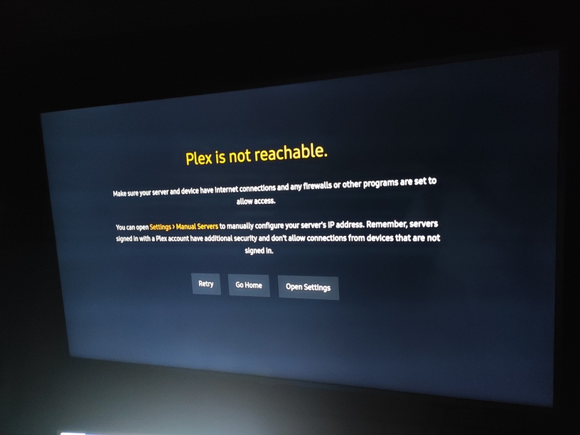

Can't do anything on Samsung Smart TV
Server Version#: 1.18.7.2438
Player Version#: 4.21.2
TV Model: UE55NU7442
I’ve been using Plex on this TV for a long time, but today I got “Plex is not reachable” error. Server is running, I can access it from other devices, and via web browser on same TV, I also see it as DLNA server on that TV, so being unreachable is not an issue. I guess it could for some reason remove static IP I’ve set, but I can’t even check, because despite three buttons (Retry, Go Home, Open Settings) being shown, application doesn’t react in any way, so I can’t go into settings.
What I tried:
  1. Using remote
  2. Using smarthone as remote via Smart Things
  3. Reinstalling application
  4. Restarting TV
  5. Reseting Smart Hub
  6. Restarting Server
  7. Updating server to latest version
Is there anything else I might even try? It looks as if player auto-updated, and latest version is broken.

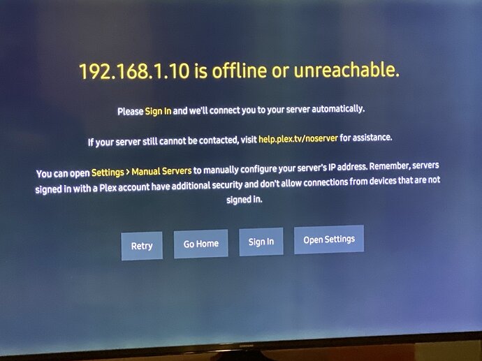

Even after uninstalling the TV app, Turning TV off and back on, and then installing and linking, it does not find the server?
If it does not, can you please provide a photo of what the TV does show?
I will take it directly to the Web-TV team.
After each of following:
  1. Reinstalling app
  2. Uninstalling app, turning TV off and on, installing app
  3. Resetting Smart Hub and installing app
  4. Factory Reset of TV and installing app
It’s stuck on this screen right after launching app (and as said, I can’t open setting, these buttons don’t even highlight), so I couldn’t log in.
Thank you for forwarding it to Web-TV team! I’ll be happy if they just fix problem with buttons so I can input server IP manually.
I just tried the same scenario and get the same exact screen as you and same with the button unavailability.
