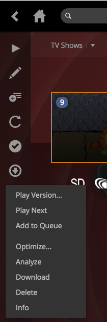

Anyone missing the split button on TV shows with duplicates? Clicking on the ellipses from the details page of the item doesn’t have the split option anymore, unless I’m doing something wrong? Help?

Or maybe, for starters, can anyone confirm that the option is missing for them too?
Any tips on how to get plex to “re-index” them and hopefully not merge them? They’re very different files with different meta data, not sure why they got lumped together.
Split is only available at the ‘show’ level - not at the season or episode level.

I still have a few that are getting lumped together. Can you explain to me what you meant by the split only being available at the show level and not the season or episode level?
I just could have sworn I had used it on episodes in the past. Seems like it’s the most likely place to have duplicates anyway…
You go to the preplay page of the show as a whole (the top level of a TV Show or ‘Series’). Then on the left side under the ellipsis the Split is available, if there is something to split.
Definitely not. ![]()
