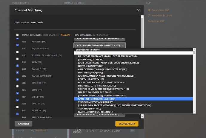

Hello!
The channel list when you map the tuner and the xmltv is out of order…
before this list was the same than the order of the xmltv … now it’s really out of order…

Could I get fresh screenshots please showing the problem - because Plex Web version 4.62.1 brought back display of channel numbers on the mapping dialogue box -
  • Show channel numbers when mapping lineup for Live TV
What has actually changed ? and was this change since the introduction of the new web screens for DVR setup?
I’m using this version of PMS : Version 1.24.2.4973
So the trouble can with the introduction of the new web screens, i have the same issue with PMS and PLEX WEB … and even if the team introduced channel number.. i have the same issue
Other issue, with a large amount of channel, the channel on the left is not aligned with the channel on the right…
here’s another screenshot
