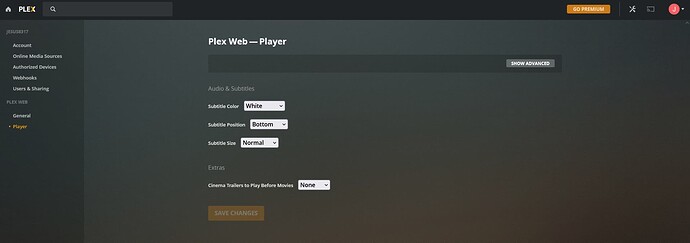

I think a big part of my problem is that I can not see the server from the settings. I am attaching a screenshot:
As far as I know, I should see my server in the left. With this I can not enable the Plex Media Server Debug logging or extract the logs afterwards…

Thanks for the update.
  1. What version of Plex Media Server is currently installed? This is visible in the Synology Package Center. Click on the Plex icon or on the name “Plex Media Server.” Do not click on “Open.”
  2. Synology model?
  3. Since you completely removed & re-installed Plex Media Server, it will be in an unclaimed state.
To claim the server, use a incognito/private browser window pointed directly at the NAS: http://syno_ip_address:32400/web.
You must be on the same network as the Synology NAS. No remote connections.
Do not click on the “Open” button in Package Center, do not use Synology Quick Connect, do not use a fully qualified domain name. Those methods will fail.
The incognito/private window bypasses cookie cutters, adblockers, etc.
If you are able to claim the server, you can proceed with configuring your libraries.
