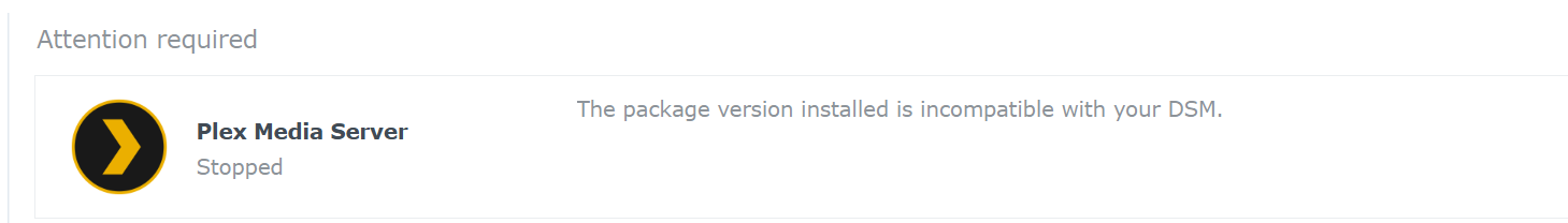

well i know of a issue, I updated to DSM 7.4 and now i get “Not authorized You do not have access to this server.” and i don’t know how to fix it…

NAS model?
Which DSM version was installed before the update to 7.4?
Synology changed packaging requirements with DSM 7.2.2. As a result, Plex created a specific package for NAS running DSM 7.2.2 and higher.
If the NAS was running DSM 7.x:
  1. Uninstall Plex Media Server. When given the option, choose “Uninstall Only.” It will remove the PMS app. The Plex Data Folder and your media files are not touched.
  2. Download and install the DSM 7.2.2+ package for your NAS from plex.tv (link).

DSM was the latest 7.2 version. The NAS is a DS918+
but seems i was just assuming… thank you that worked!

Update to PMS for DSM 7.2.2+. You’ll want the Intel/AMD 64-bit version.

yes after reinstalling the 7.2.2 version it started working again.

Could you please clarify if you reinstalled the 7.2.2+ Plex Media Server package or if you reverted to DSM 7.2.2? My understanding from the latest DSM 7.4.1-90080 release notes is that you won’t be able to revert to previous versions
I installed the 7.2.2+ Plex Media Server package. I was under the assumption that it was already installed but that seems to have been not the case. Everything worked after the install of Plex.
