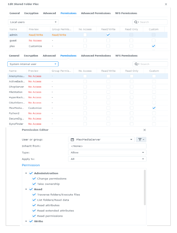

I hate asking for help but I’m really stuck. I read the entire document and honestly thought I was doing everything correct since so many people seem to have figure this out I thought I could do it but I’m sooo stuck. Here are the permission screens. They seem to be right?
Aarrrggghhh! Thank you for yelling at me. For some reason my brain was frozen. Got it!
I needed to be yelled at. I was being really dumb. Thank you. I mean it. I’ve been a Plex Pass member since the very beginning and I like to think I know a thing or two and when that happens being knocked down a notch or two is exactly what I need. Thanks again.

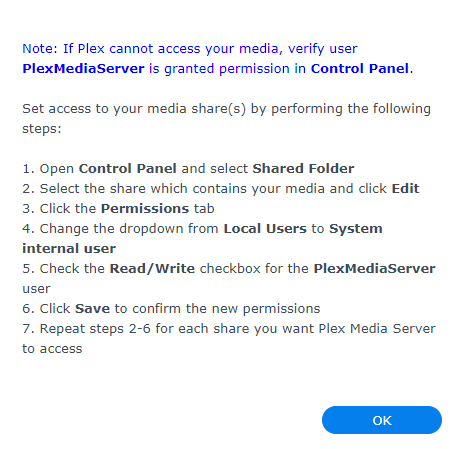

I always get this:
Is there any way to check any log file where it goes wrong?
That message is a reminder to you.
It may not address all problems but does address the vast majority.
This is how you remedy those which have something strange (holdover from DSM 6) in them

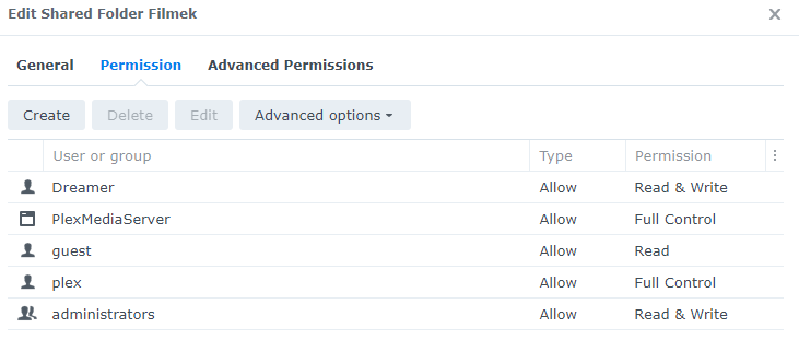

I already gave Full Control to the folder where I only have media files for Plex, so unfortunately re-creating the permission has not solved issue (not even modified the existing settings):
