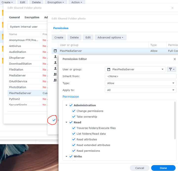

Anyone who cannot use the default Synology photo share with Plex.. please respond here with logs which capture this (permission denied shows in logs)
Internal system user has read/write permission on shared folder “photo”. But in Plex I do not see any photos. Clicking on “read media files” produces the following error in the console:
Error scanning directory, we’ll skip and continue: boost::filesystem::directory_iterator::construct: Permission denied: “/volume1/photo/Sabine”
On Control Panel > Shared Folder there is no possibility to add “Custom” permissions (only read/write) and also no way to "Apply to this folder, sub-folders, … ". Please see attached screenshot

Can you please show me the permissions you have set for the photo shared folder?
Also can you please attempt to scan the folder again then attach the log files?
I believe you have captured exactly what Synology needs to see.
I found a solution: I had to convert the shared folder to windows acl. @trumpy81 After that, the dialogs for changing the user rights looked exactly like yours.
I too can confirm that by selecting “Convert to Windows ACL”, re-doing the advanced permissions for System Internal User “PlexMediaServer” - and rescan in Plex Photo, all pictures appear w/o having to create a duplicate files for Synology Photo and Plex Photo.
Make sure you apply to all folders, and allow PlexMediaServer access to everything…
Thank you.
That is so counter-intuitive.
Linux ACLs → Windows (Syno?) ACLs – Now add “SynoACLs” (synoacltool) for PlexMediaServer.
