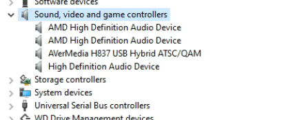

Here you go. I also wanted to grab this so you can see it in the device manager
Capture

<Device parentID="11" key="1" uuid="device://tv.plex.grabbers.tunerservice/dvb%23bda%23usb%23vid_07ca%26pid_0837%26mi_01%236%2634910875%260%260001%23" uri="" protocol="livetv" status="alive" state="enabled" lastSeenAt="1621130860" make="AVerMedia" model="AVerTV Volar Hybrid Q" modelNumber="H837" source="0" sources="0,1" thumb="/:/resources/dvr/device-usb-560.png" tuners="1">
