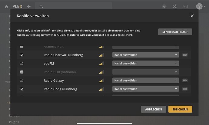

Hey Plex Family,
Since a few weeks I‘m experiencing plex loosing the Live TV & DVR channel mappings, or changes the mapped channels.
This causes my recordings to fail.
When remapping the channels manually everything works fine for several days or weeks.
I just upgraded to PMS version 1.22.0.4163
Anyone experienced this issue too?
Very frustrating if you want to watch a recorded show any find out that the recording failed :disappointed_face:
I’m having exactly the same issue. Last time I mapped out all my channels again I took notes and wrote down the channel numbers (e.g. 170 for ARDGRHD) as I thought, when it happens again I’ll be faster to bring them back. Now I realized that since it lost the mapping again, the channel ARDGRHD is no longer 170, it’s now 220. That’s probably the reason why the mapping gets lost.
So I wonder why the IDs are changing?
Just realized, that all channels with an ID greater than 100 got a new ID which always added exactly 50 to the ID - for ALL channels. The channels with an ID below 100 remained unaffected.
Examples: 3sat (011) and arte (050) remained unchanged and continued to work.
All others got increased by 50:
  • ARD HD from 170 to 220
  • ZDF HD from 1146 to 1196
  • Sat1 from 826 to 876
There is nothing in the logs that would help understand that, hopefully the developers can make any sense of that?
I double checked my configuration with screenshots from the first remapping, seems to be the same issue. Maybe Plex Support can jump in here?

@sa2000 I’m on DVR—Deutschland (erweitert) (980 channels) like many others reported as well. The country is Germany and postcode is 78244.
The channel numbers that changed are NOT those on the left. It’s those on the right (3. column names “EPG Sender” in German). And it appears it’s only those above 100, those below 100 never changed to me and all others are changing every other week.
