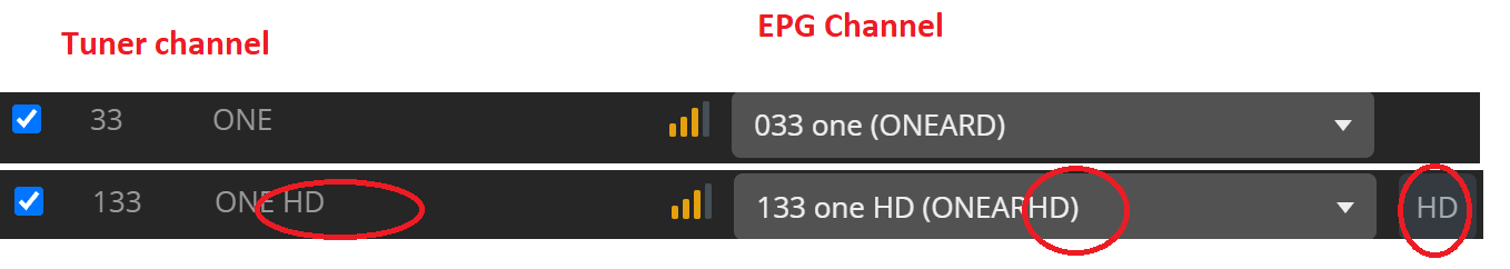

These days i noticed, one Channel is a bit mixed up.
033 usually ONE [133 ONEARHD]
133 usually ONE HD [033 ONEARD]
The DVR mixes these channels… If you want record HD the SD channel is recorded so i had to switch the assignment. - but it’s still declared not correct and also the Logo is switched.

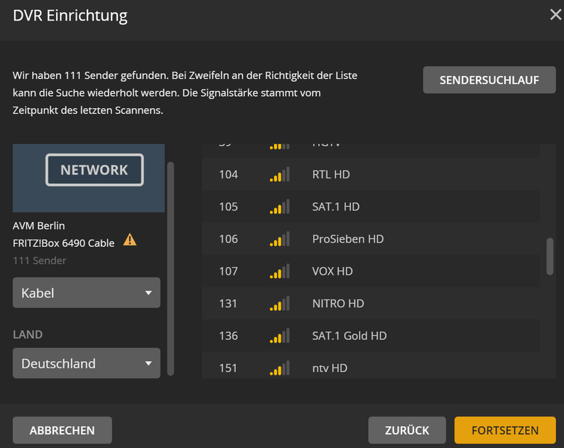

OK, i just rechecked transponder “cable Cologne” on a TEST-Server. (Windows 10)
The Scan just find crap:
111 Channels but many non usable pay-tv HD channels - most free-tv channels are SD.

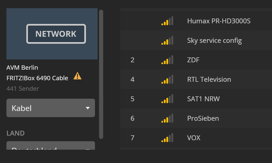

I have tested now these FastScan parameters:
1=113000,V,6900,,QAM256
1=322000,V,6900,,QAM256
1=602000,V,6900,,QAM256 KMS Munich FastScan (8009.ini)
Other FastScan did not work:
  • Telecolumbus 8008.ini (146000)
  • Unitymedia 8010.ini (146000)
And Yes, in all working cases the Selection was ID: 777

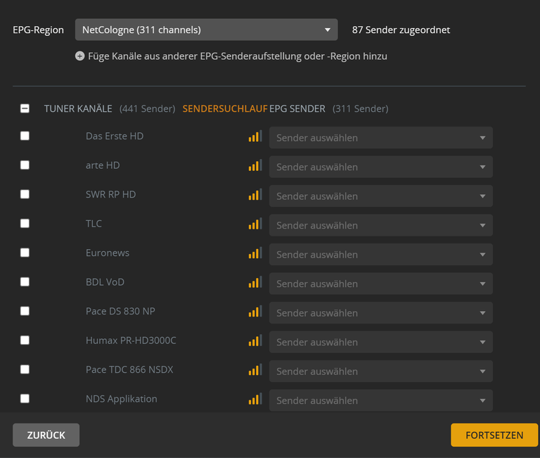

FastScan found 441 channels, thats much better.

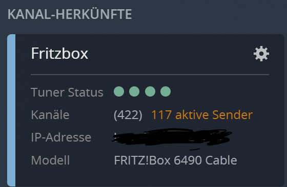

My DVR on Synology NAS with my own 5211.ini has only 422 Channels. (117 active)
Ok , different PC/Browser works… (Or maybe because server was not connected, yet)
As default, the Region “NetAachen (312 channels)” was selected with 88 assigned Channels.
By switching to “NetCologne” only 87 Channels are automatically assigned. - so i have 30+ to fix manually.

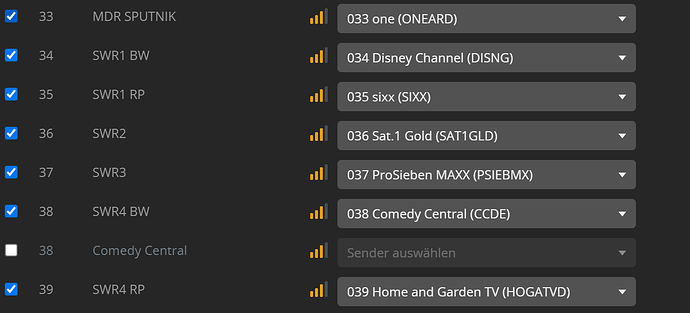

Finally the automatic assignment is:
033 is SD Channel if i press play it is also SD, but EPG is connected to HD.
133 is HD Channel if i press play it is also HD, but EPG is connected to SD.
So if you want to record this channel the HD/SD is switched…
The channels are correctly marked as SD and HD in the lineup with 133 having the HD indicator but two things are wrong
  • the logos are the wrong way round in the NetCologne (311 channels) lineup
  • the schedule for 133 does not have any HD airings - all having 480 resolution.

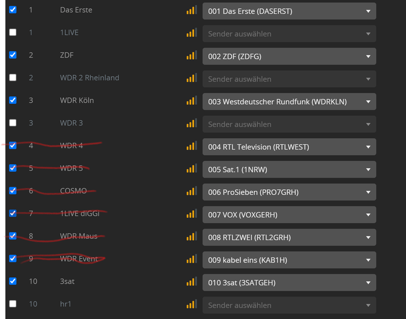

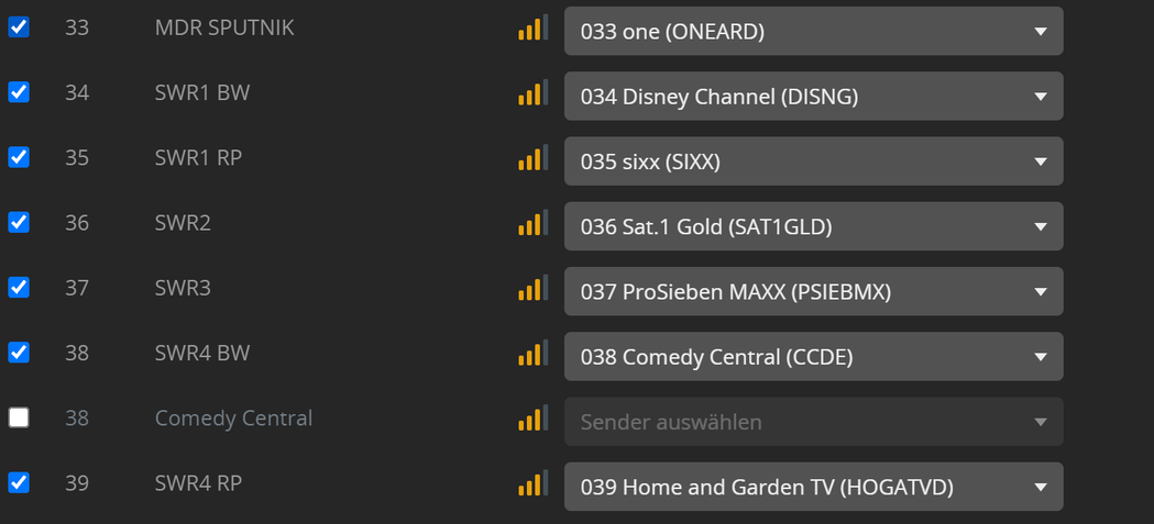

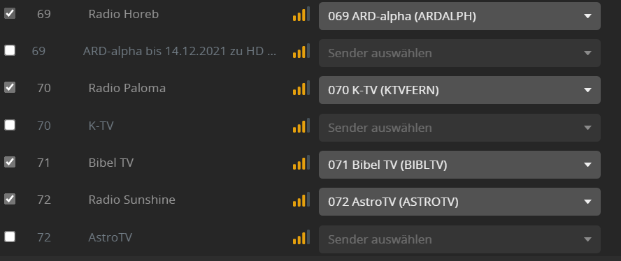

see for example TV-SD Channel 69, 70, 72
but Radio must be 1069, 1070, 1072

069 ARD-alpha
069 / 1069 Radio Horeb wrong connected to ARD-Alpha EPG
070 K-TV
070 / 1070 Radio Paloma wrong connected to K-TV
072 / 1072
073 / 1073 correct assigned, but also radio Double ORF2 Europe / BBCW SERVICE

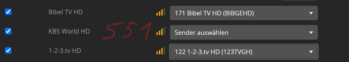

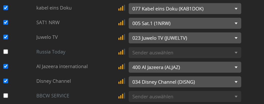

408 Russia Today missing in EPG
494 Tunisia 1 missing in EPG
551 KBS World missing in EPG

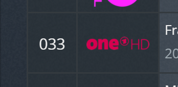

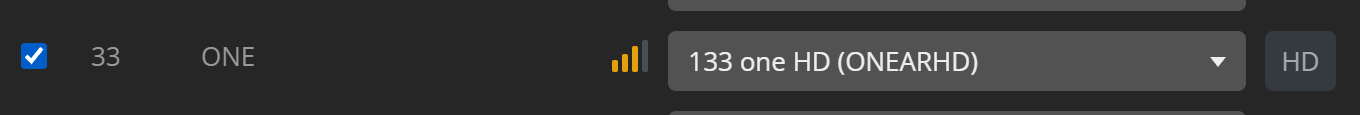

This screenshot does show that the EPG channel 133 has HD indicator and the callsign does have HD as part of its name
This screenshot shows that Gracenote have the wrong logo for the 2 channels - they are swapped round
I understand that streaming from 133 OneHD is not 480 - but the EPG schedule data from Gracenote has all airings set to 480

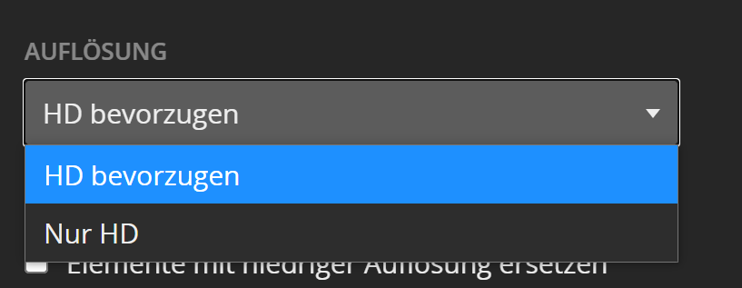

  2. The EPG Shedule only refers to an airing, not the Channel. The option for the rcording is set to “prefer HD” or “only HD”
    But both HD options references Channel 33 and not 133.

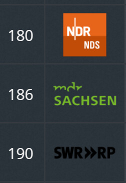

Btw. some HD Channels show just the wrong SD logo but the airing is correct.
110 3SatHD
121
122
130 ZDF_neoHD
180 NDR HD (but the actual logo should be on SD Channel 80)
186 mdrHD
190 SWRHD

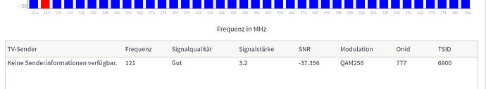

DVB-C Frequency Spectrum
All Downstream channels on cable are QAM256, also DSL, only DSL-Upstream is QAM64.
