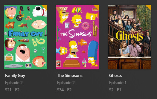

Greetings. I recently observed that in the Plex Web interface (as well as the Android interface), some new shows are appearing with the episode number for the episode name, while other episodes are appearing with the correct episode name. Observe the screen shots below.
Is this caused by incomplete EPG data?

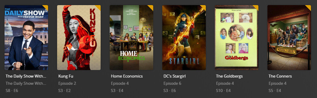

When TV recording completes, the episode recording is listed in TV shows without the episode title being populated. Print screen shows example of title missing. The second print screen shows recording file name as created by Plex server.
Problem initially happened intermittently but now happens with every Plex TV recording. No changes made to Library Agents (although doubt they have any bearing, sin…
Symptom is the same, except I posted as the title not populating. My problem would also show episode number. If I clicked on the edit pencil, the title was blank. If I manually added the title, then everything displayed correctly.

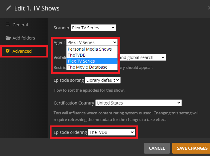

Library => Manage Library => Edit => Advanced.
Scanner and agent should be the Plex TV Scanner
After you change the agent, I think it will prompt you to refresh the metadata for the library
The default show order is TMDB
Change it to TVDB in the episode order first if that’s what you’ve been using
Thanks for the guidance. It looks like those settings were already in place.

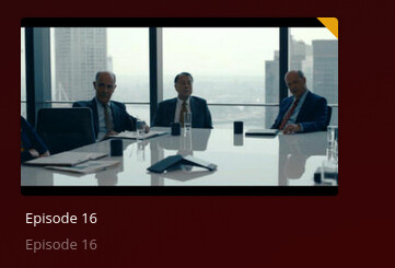

Completed the Plex Dance on the file. After rescanning the library, same result - Title field is blank and name showing episode 16.
