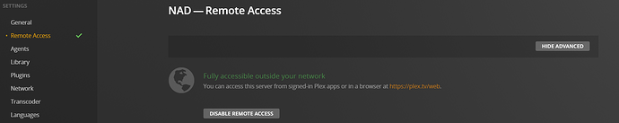

Dear,
I would also like to be put in the queue to fix my cert. After the password reset I had problems with access to my server. I fixed these. Remote access supposedly works (see screenshot).
I can access the server via the Plex app for Windows and PlexAmp. However, I can’t access the server on app.plex.tv. I see following error in the local console:
Aug 25, 2022 09:59:08.714 [0x7f0797a48b00] Error — [Req#e8] CERT: Error acquiring new certificate: Failed to upload CSR: 429, <?xml version="1.0" encoding="UTF-8"?>
<errors>
  <error code="1003" message="API rate limit exceeded" status="429"/>
</errors>
Aug 25, 2022 09:59:14.148 [0x7f0799d8fb00] Error — Unknown metadata type:
Aug 25, 2022 10:01:11.267 [0x7f0795cbdb00] Error — [Req#e8] CERT: Error acquiring new certificate: Failed to retrieve cert from plex.tv: 429,
To answer the requested questions:
  1. Yes, a password reset was required
  2. Yes, the password has changed
  3. Yes, all devices were signed out
  4. Server name NAD, OS DSM7.1
I also want to add that http://127.0.0.1/identity does not work (ERR_CONNECTION_REFUSED).
Thank you for your help in advance.
  • Edit: Fixed. Thanks!
