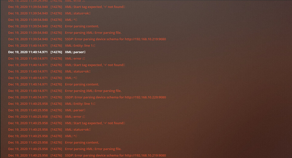

Mine is doing the same. Takes longer than 30 seconds. I have been using Plex with my own files for years with no problems. Now that I bought Plex Pass and use live Tv with HD Homerun Prime, I have issues. DVR seems fine. Hd Homerun app plays live tv no problem. All devices are wired by ethernet. Server is on i7 4790 and client is fire stick 4k. I attached errors from logs. Could those be causing problems with live tv? Also, windows 10 client gets playback error and kicks back to guide after a while.
I am also getting those XML errors but I don’t think they have anything to do with the issue.
