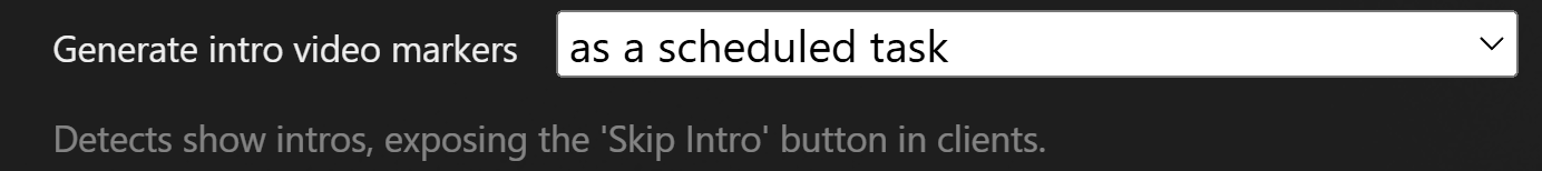

The above example has obviously been parsed with the scheduled butler and now has markers, so as long as you have set your scheduled tasks appropriately, they should eventually get markers.
This is how I have mine set, and the only reason I chose NOT to do when I add new media is because I am constantly adding and changing new media.
I have a script on my server that runs these items at the time of my choosing, that way I can add and change things and the server won’t be flat out performing these tasks immediately on add / change…

Yeah, can’t help you with commands on a NAS, but just make sure you have set your library schedules and then wait till tomorrow to see the results…
It’s already set as a scheduled task but idk when it’ll get to the shows I want it to. My library is quite large.
