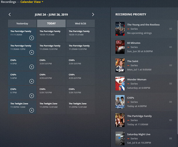

I don’t know if this is the same issue I am experiencing, but I have show young & the restless scheduled, it shows on the guide, but on my recordings it no longer shows any airings.
I have tried cancelling and re-scheduling it multiple times, as well as multiple guide refreshes.
Other shows appear to be showing airings.

@sa2000
I was able to resolve my dvr issue (no airings for Y&R) by disabling enhanced guide and then refreshing the guide.
so something is messed up with enhanced guide data.
see previous image above, versus new image below
Your previous screenshot showed the episode as being “2019 E1” - Corrections for this were being done in the background - it is unlikely to be the disabling of the Enhanced Guide pref and more likely that you did an EPG refresh that fixed the episode info
well, I refreshed the enhanced guide, waited for it to finish, there was still no Y&R airing. (shows in the GUIDE but not the recordings)
btw I have manually refreshing the (enhanced) guide multiple times since I posted originally.
then I unchecked enhanced, refreshed guide, and nearly immediately there was Y&R airing in the recording as pictured.
so unless there was something changed today within ~30 minutes of the time between refreshing enhanced, and refreshing non-enhanced…
ok well…
I re-enabled enhanced guide
refreshed guide
now Y&R remains airing in the recordings.
so whatever act going from enhanced, to non enhanced, cleared or fixed something that was preventing it from recording previously.
