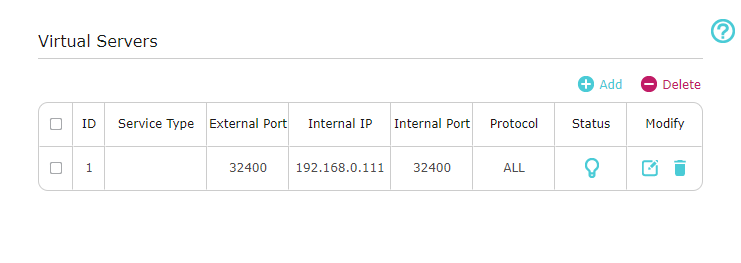

My server is on my laptop that is connected to the internet via VPN. I had no issues in the past and couple of weeks ago… poof no more Plex, not even relay connection. I’ve searched and searched, adjusted router settings. The server is showing that it has all the connections but I can’t see the server anywhere. HELP!

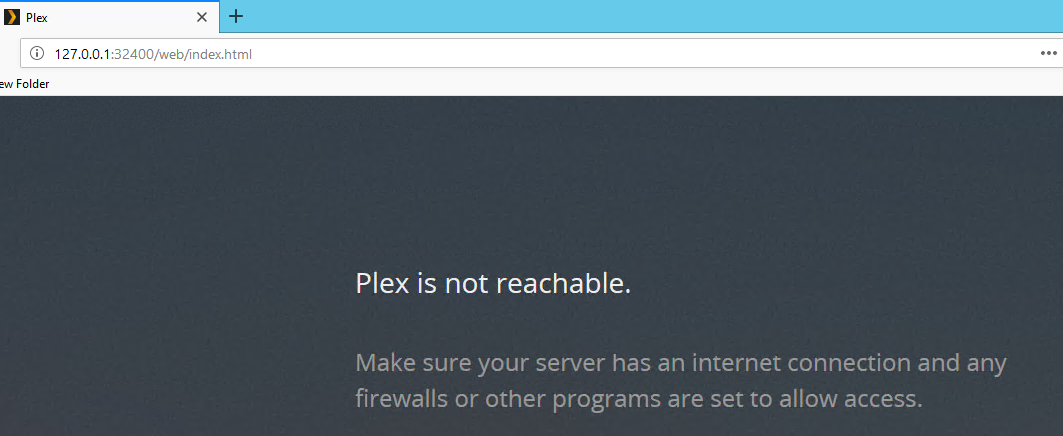

I’m not sure what the issue is but I can’t even access PMS from other network browsers (https://[pms address]:32400/web)
I can ping the IP address just fine…
From the server itself, can you access http://localhost:32400/web ?
On the server device I can access
http://127.0.0.1:32400/web
If you can get to the local Plex server from the localhost, but not another internal host, you’ve got some firewall issue going on on your windows computer hosting Plex. I’m no expert on Windows firwall though.
Do you think everybody is having firewall issues all at the same time?

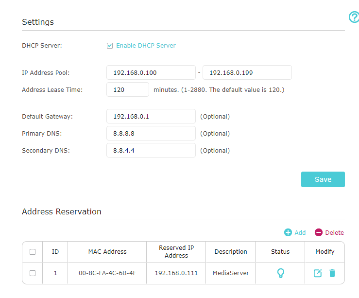

I would make sure your ISP didn’t change you to an internal IP (if the modem is a router too) you may need to get them to change it to bridged mode. That would make you double NAT’d and you wouldn’t have access…
Also, your MTU size should be 1500 not 1300 (unrelated)

I have my own modem and router (separate)… Not double NATd
I changed MTU from 1500 to 1300 since I found out Plex has issues with big blocks.
