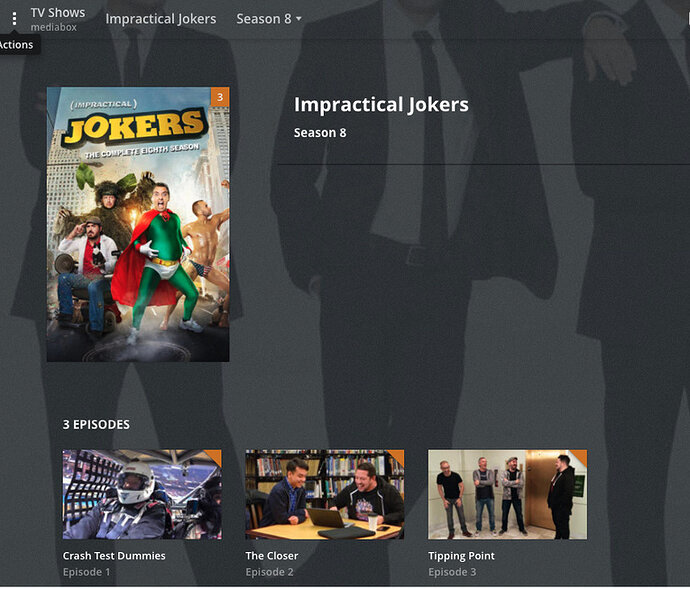

I have season 8 of this show and for some reason plex will scan it, pull the correct metadata, and then change the game up. It takes a few minutes and then says there are two seasons (there is only one) and calls them both Specials and renames the episodes.
I have tried changing my agent order several times, doing the plex dance, and starting from scratch but it cannot seem to manage the seasons of impractical jokers properly. I noticed when I added all of the seasons it did the same things with select episodes from each season.
All of my files follow plex’s naming guide exactly. Anyone else having this issue or know of some solution?

Also added season 7 back in and it got even weirder!
Now there are 2 seasons, plex says 3
1
2
it seems the episode count is also off by 2 episodes.
