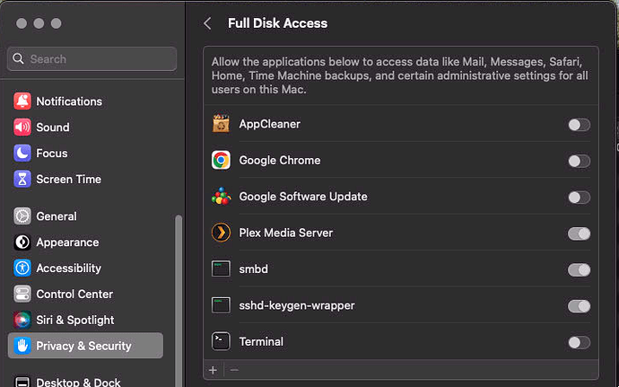

Have you given PMS permissions to external drives? In System Prefs > Security & Privacy, then under Files and Folders you can give it permissions to removable volumes (external drives), or under Full Disk Access you can give it permission to everything.
It looks a bit different depending on how recent your Mac OS version is.
Unfortunately it already had access to the removable volumes, and even after granting it full disk access it still isn’t recognizing anything new.
