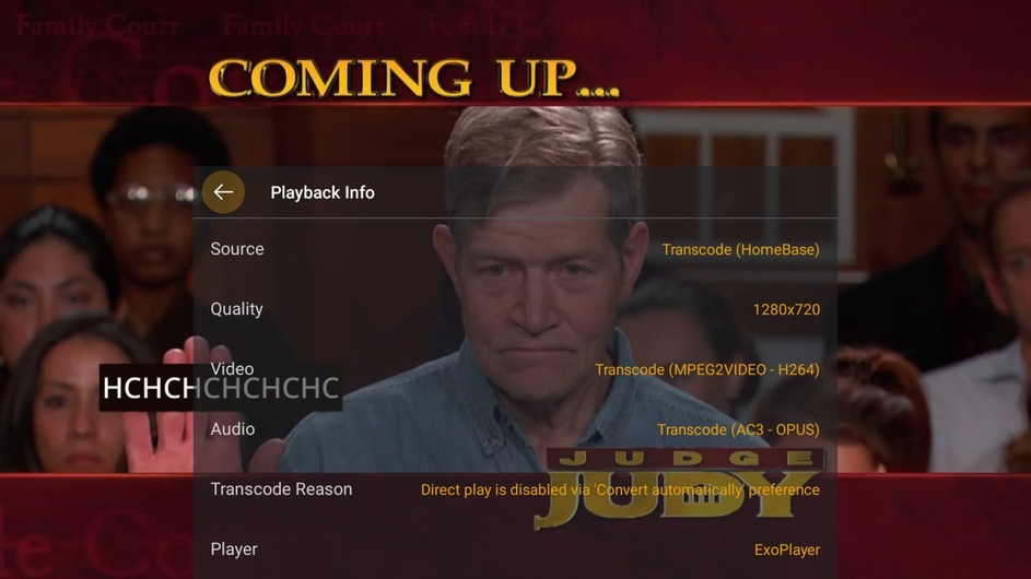

@ynk1121 I think I see what you are saying, I can direct play from my admin account just fine:
However all non-admin accounts force me to transcode or they will not play:
So it is definitely not an issue with the streaming device being able to play direct or not, it most certainly can, however plex will not do so on any account other than the admin. And then of course, when it does transcode on the the other users, the captions are bonkers, Judge Judy definitely did not say HCHCHCHCHCHC there,
@jpfeifer14 Judge Judy just coughing up a hairball. :joy:
Yeah, my thought is literally the exact same bug is happening on the Android clients. Only difference is the Windows/Linux clients are able to continue playing despite the bug.
