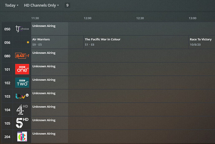

My HD related problems are these:
  1. "Unknown airing" displayed in guide if I select "HD channels only"
  2. Plex will not record episodes from my HD channels if I select:
    → “Resolution: HD Only
I think these two issues are related i.e. Selecting “HD Only” prevents both airings being seen and also shows being recorded.

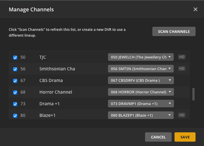

Additionally I’m still seeing the following channels identified as HD when they are SD:
  • 050 - TJC
  • 056 - Smithsonian
  • 080 - Blaze +1
As reported during the beta as well as in this thread here, here and here.
I am the same as you it seems. Out of interest you don’t have FreeSports in that list, is that just because your tuner doesn’t pick it up/you’ve turned it off OR is it marked correctly as SD in your EPG?
It wasn’t a channel I was aware of but It looks like my tuner isn’t picking it up :frowning:
No Freesport
I only have 22 channels switched on (the ones I watch/record), so I just switched your 3 on to see what I get:

As above, random channels identified as HD when they are not. The “HD Channels Only” drop down box now gives unknown airings galore so every time I want to schedule a recording I have to scroll down the list of channels to get to the HD ones on the main view.

I’d noticed the “Unknown airing” with the “HD channels only” issue, so I decided to have look in the EPG database and see what the difference was between the known and unknown airings.
The media_items table has width and height columns and it appears that the unknown airings have width=720 and height=480 while the known airings (on the Smithsonian channel) have width=1280 and height=720.
I updated the database to change the width and height for one of the unknown airings and after refreshing the EPG page in Plex, that airing showed up.
That suggests that the “HD Channels Only” filter doesn’t just filter the channels on those flagged as HD but also filters on the resolution of the individual programs and that the unknown airings are SD programs being broadcast on an HD channel (or Plex has the resolution wrong for these programs).

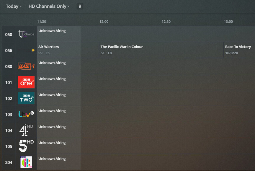

I also have some channels showing as HD (when they are SD) and the Unknown Airing issues when filtered to HD only on the EPG:

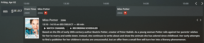

However, I had a couple of oddities with a few of my scheduled recordings next Friday:
  • 5 Select: Fri 2nd April 13:10 - Miss Potter
  • ITV2: Fri 2nd 14:55 - Harry Potter and the Philosopher’s Stone
  • ITV2: Fri 2nd 17:55 - Harry Potter and the Chamber of Secrets
a) The guide is showing two parts with the first being an hour long. The 5 minute interval has been removed so one of the parts has been extended but it looks like the two parts haven’t been stitched back together:
Restarting Plex for Windows seem to solve this issue.

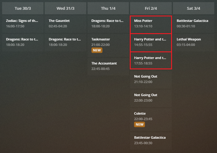

b) The DVR schedule appears to show only the first half as being scheduled to record and not the full movie:
Restarting Plex for Windows didn’t resolve this but restarting the Plex Server software did.
I’m not sure what is happening there but if anyone else has similar issues I would recommend restarting the software.
Thanks for the feedback @captain_caveman2k. Butler tasks should have cleaned these all up over the subsequent 24 hours, your actions just accelerated the process. If anyone does find themselves stuck in some of these states by EOD tomorrow, please post here.
