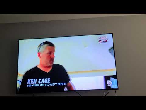

Check out at the 50 second mark is this the same issue you’re having? It’s happening on the old video player as well and on the 2019 Shield just not as much. I did rewind 10 seconds back at around 55-second Mark to see if the issue still persisted which it did.
Yes it’s the same issue but me when I rewind or fast forward it temporarily fixes it self
Okay cool I have people looking into it. Yeah generally the rewind thing fixes it for me as well this is the first time it didn’t do it.
