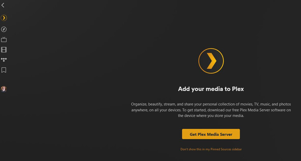

Thank you for trying to help. I don’t know if I’m explaining it the right way, but I have downloaded, several times now, the request in picture two. I realize picture one says Plex Web vs Plex Media Center, but I don’t seem to have the right links for anything else. Normally I would have a squiggle/scan button, but that is gone. I hit settings and these are my choices (figure 1).
I am on Windows 10, the server gets restarted every day. I don’t feel like I am computer illiterate, but maybe I am. I have tried deleting tokens in the registry and I watched more than one YouTube tutorial, but I’m still stuck. Now I can’t even see the claim server button in Chrome for some reason. I bookmarked it, but it won’t let me back in saying the site is unreachable. I could have used that picture for a third figure to show you what I’d normally see if everything was working perfectly. Thank you for everyone who is trying to help.

This is what happens…I get a blinking claim server in the tab and endless searching as depicted here…
