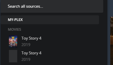

check this out, it seems movies are getting added twice? this is happening with a bunch of movies,
Also the toy story 4 with a picture shows as the old path, the blank one with no metadata shows as the new path,

I suspect this is probably okay and normal based on the steps from @dane22 above Moving Metadata from windows to Linux question, - #4 by dane22
Its likely still scanning and matching so I’d suggest letting it fully finish before finishing the rest of the steps outlined above.
BTW… in case you don’t know you can check under setting → status → alerts as the scanning and matching is happening. I typically use that when I’m doing a large scan of media changes to see the status of it.

Yep you were right, waiting it out and its all fixed itself,
great thanks for the help, ill just let it do its scans and such now
A watched kettle never boils :grin:
You may need a little fix matching depending on your media naming but let plex do its stuff first and then see where you are.
Looks like the scans have completed and all done correctly. good stuff
