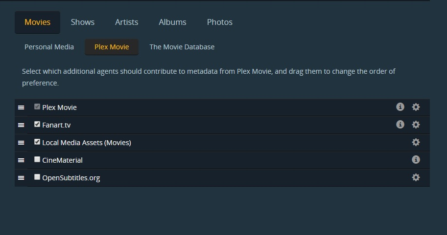

What FileBot can’t do is remove possible embedded metadata in the Title Field of MP4/M4V files. Plex will read this info and prefer it over a perfect file name/structure, but you can combat that situation by moving Local Media Assets to the bottom of every agent list you can find. All tabs in TV Show and Movies here:
https://support.plex.tv/hc/en-us/articles/200241558-Agents
Just drag LMA to the bottom of the list and drop it. If you do have embedded metadata this will cure the issue, if you don’t it won’t matter. LMA will do what it has to from the bottom.

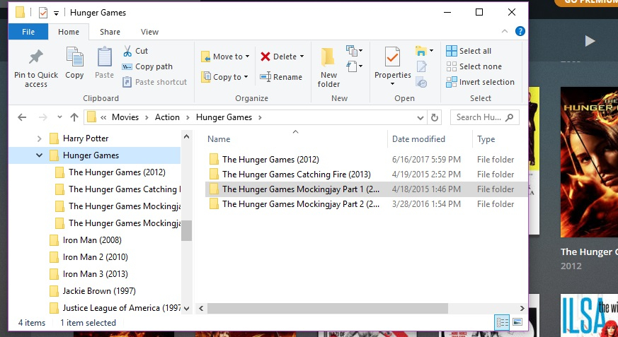

Anyway, as you’re renaming your files, make sure to rename your folders as well; cause the folder and the file names need to match. Unless you need it for some reason; get rid of the extra info in your filenames, like 1080p; etc. . .
You should end up with something like this:
Which should give you this:
Good luck.

Juice, I LITERALLY copied and pasted your “absolute correct and proper file names”. I triple checked information to make sure no lingering metadata was there. LMA is at the absolute bottom of my agent list in every conceivable way. I even followed flamebird’s suggestion and completely exited out of Plex and restarted it after not one but TWO full Plex Dances.
Now, as you’ll see in the photo, Plex isn’t even loading ANY metadata at all. I just get a cropped out cap of Gale’s face in some random scene.
