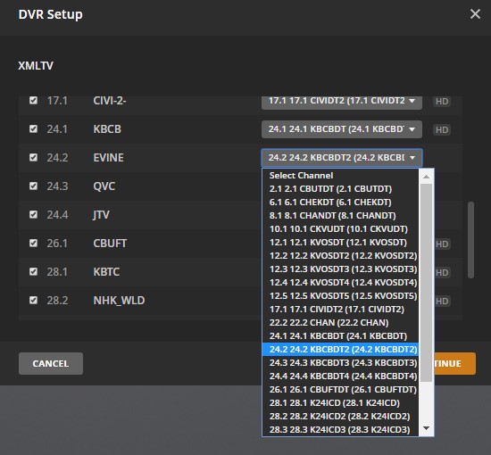

Using Plex 1.16.2.1297, deleting and setting up the tuner again under 98230, you can see that 24.3 & 24.4 don’t have matching guide info. It goes from 24.2 to 26.1. Although I could technically use the guide for 33.5 on 24.3 for QVC, there is no matching guide for 24.2, which is labelled as EVINE.

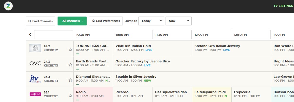

Here is the image from Zap2It that correctly shows that QVC is on 24.3 and JTV is correctly on 24.4.

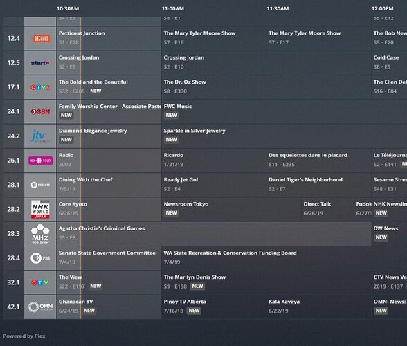

Here is an image of the Powered by Plex guide info from 1.16.2.1297 of channel 12.5, which incorrectly shows that “Crossing Jordan” is currently airing at 10:30 am PT.
