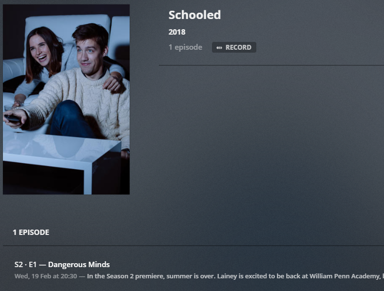

Schooled Series 2 premieres on E4 in the UK on Wednesday (19th February) but unfortunately my series record is failing to pick it up:
@sa2000 Could this be a problem with the series information in the guide or do you think I have out of date series record info from when I was using the National Lineup?
Iâve set up a new recording but some of the data in the EPG does look right either as the artwork isnât coming through:
Iâm not sure if both are related or just coincidental but thought you should know.

The airing is correctly showing as Season 2 Episode 1 and also has the Premiere flag set. The original air date appears to be from September 2019 - I presume that was the first airing outside the uk.
So it ought to be ok. If there is an old ID - delete the scheduled recording and recreate. Best first to do a full EPG refresh

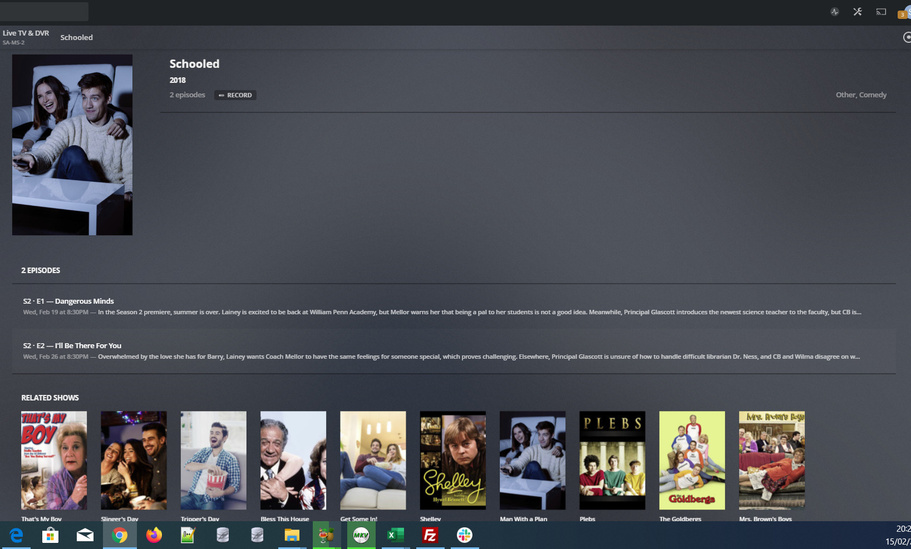

which bits ? the art work we have is an image at the show level which is what is shown. In Plex Web I see the following when clicking on the show
Sorry badly worded post on my part - you should have seen my typing on the #curl IRC channel yesterday - absolutely terrible, Iâm not sure I made sense to anyone but myself (and even then that was intermittent!).
Anyway, specifically it was the artwork. Yes, artwork is included⊠but it doesnât seem right to me as:
- I was expecting either: The main Schooled artwork that I see in my TV library or specific artwork for Season 2.
- It is the same as âMan with a Planâ - as youâll note from the âRELATED SHOWSâ part of your screenshot.
I was then wondering if the series information was wrong altogether and if that was why my series record of Series 1 hasnât picked up the new Series 2.
Even now - Iâm not sure Iâm making sense. Maybe itâs time for a walk down to the pub!

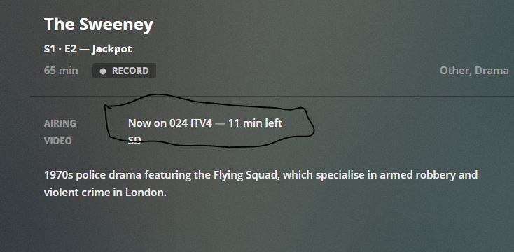

Another example of an annoyance in the Starting Soon, I know this is supposed to only look at airings after 7pm, but the details need to relate to the channel shown in the Starting Soon page
Details when clicking

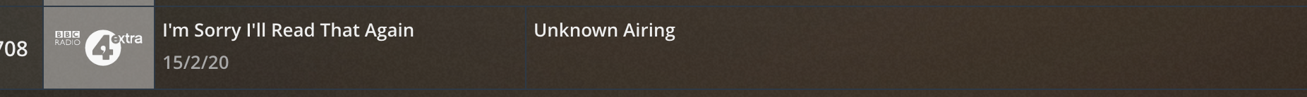

Radio4 extra is losing shows again (including right now) - and then disappears completely on Sunday. Screen shots attached. Freeview STV Central OTA Broadcast
I just checked todayâs data. The guide data for Radio 4 Extra does currently have a few gaps which show up as an âUnknown Airingâ - Most are 30 minute or 60 minute gaps. We are currently re-engineering how data is ingested at our to avoid gaps.
I am chasing this frequently. The last I have is that our provider has just picked up data for week beginning 22 Feb 2020 and it would start to show up soon
I have relayed the statement that I received from our provider. I do not know when their weeks start and if it is a Saturday or a Monday
I have added this example to what has already been referred to our Plex Web app team. The issue appears to arise due to the +1 channels
It seems that artwork is still being shared between between âSchooledâ and âMan with a Planâ:

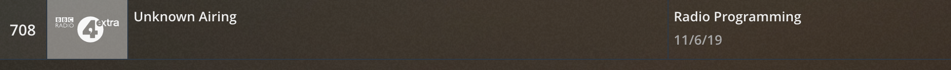

Anyone else getting their guide populated with the old â[channel name] Programmingâ entries?
Hereâs an extract of my guide for Sunday after a manual refresh:
Itâs not all channels, but itâs quite a few of them, including ITV1-4.
Yes, Iâm seeing that as well ( Freeview STV Central OTA Broadcast) - it seems to start about 4:45am on Saturday, with STV, then seems to spread to other channels.
Screenshot attached - on STV, nightscreen should go on until 6am, when the first programme should begin.
By Sunday, there are about 9 channels affected (not including the â+1â types).
These are stock photos that always appear if there is no suitable poster found. Get Some In! on your screenshot also has it, just a different one (different genre?).
