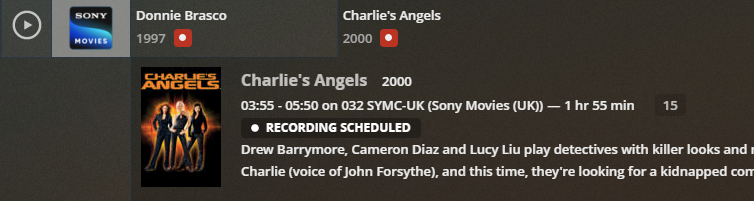

The showing on Monday the 18th May was also wrong but I didn’t touch the computer on Friday or over the weekend to check so Plex recorded it.
It also looks like the upcoming showing next Monday (25th May at 03:55) is also wrong:
Versus the FreeView Guide:
 and the guide over at Sony Movies also has it correct so I’m not sure why Plex keeps getting this movie so wrong!

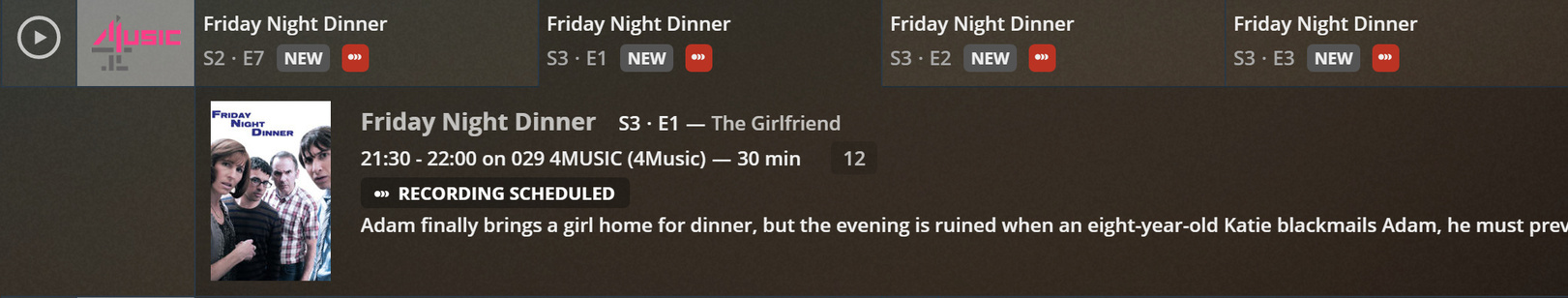

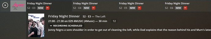

The repeats of Friday Night Dinner on 4 Music (Channel 029) of Seasons 2 and 3 should not be tagged as “New” as the premier of Season 6 has recently finished airing
S02E03 - Friday 22nd May: 21:00
S02E04 - Friday 22nd May: 21:30
S02E05 - Friday 22nd May: 22:00
S02E06 - Friday 22nd May: 22:30
S02E07 - Friday 29th May: 21:00
S03E01 - Friday 29th May: 21:30
S03E02 - Friday 29th May: 22:00
S03E03 - Friday 29th May: 22:30
I think the US is an episode ahead of the UK. Not sure.
