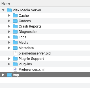

@mmmbisto How about installing PMSLibShare?
This creates a new share on your QNAP pointing to the Plex directory and looks like this…
31
Note: I am on a Mac, but will look the same on Windows…
[edit: added Mac comment and referenced mmmbisto]
